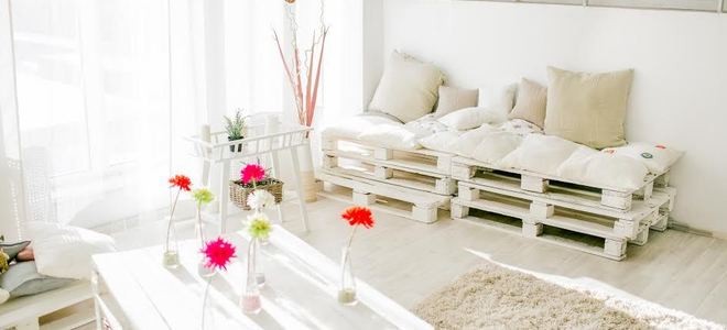

A white living room with furniture made from pallets.

Repurposing old wood is a big trend in DIY design, but it’s not always safe. Sometimes, it’s a really bad idea because old wood can be full of pests and hidden dangers. But when you clean and sanitize your old wood the right way, there’s no limit to what you can do. Here's how to treat it properly prior to using it for your projects.
