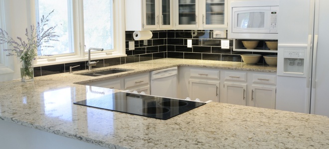

Faux granite countertops add aesthetic value to the kitchen or any other part of your house where it is used. But natural stones like granite are costly. Thus, you can use a look alike faux granite countertop instead of real granite in the kitchen or in the kids' room or any other places of your choice. These faux granite countertops give an almost identical look to that of the granite countertops. However, faux granite countertops need to be cared for just like you care for granite countertops.
