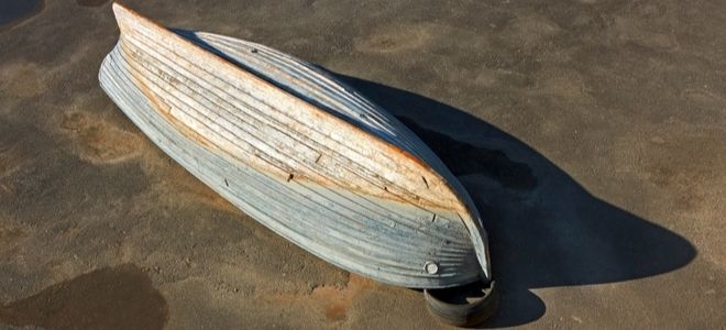

A boat spends most of its time at rest in the water so it is inevitable that algae, barnacles and other marine creatures will settle on it. This extra growth is not necessarily harmful but it does lower the performance of the boat.

Boat cleaning for wooden bottomed boats tends to be more challenging and more physical, hands-on work. The type hull will dictate whether a pressure washer can be used. Obviously it is not a good idea to use lots of pressure if the hull is heavily caulked. Generally a wooden bottom should be scraped clean.
