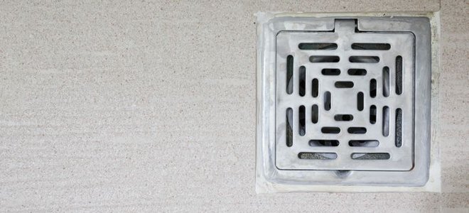

If the floor drain in your basement is clogged, you run the risk of a flood that could damage furniture or stored belongings in the basement. Fortunately, you can use a power auger to quickly unclog even the toughest blockages. This simple how-to guide will show you how to unclog the floor drain in your basement with a power auger.

Step 3 - Remove Clean-Out Plug on Drain Pipe
You need to remove the clean-out plug on the drain pipe. To do this, locate the plug on the pipe in your basement or underneath the sub-flooring. Then, use an adjustable wrench to remove the clean-out plug. If the plug is difficult to remove, spray it with some penetrating oil and wait about 30 minutes before trying again.
Step 4 - Insert Power Auger into Drain Pipe
Once you have the clean-out plug removed, take the power auger and feed some of the cable into the drain pipe at the clean-out plug area. Alternatively, if you don't have a drain clean-out plug, you may want to simply remove the drain cover on the floor and place the cable for the power auger into it. Place the cable into the drain pipe until you start to feel resistance caused by the blockage.
