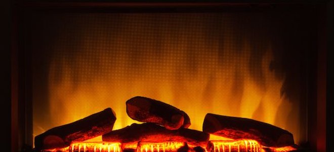

An electric fireplace that is switched on.
