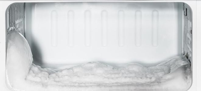

Defrosting a freezer isn’t exactly the most glamorous task, but it's one that must be done from time to time. You’re probably wondering what the point of defrosting your freezer is. It’s actually an important kitchen task that helps increase the life and performance of your refrigerator. The point of manually defrosting a freezer is to help it maintain efficiency. It should be done every time a quarter-inch of ice builds up inside your freezer’s interior walls. While it may be tempting to do this as infrequently as possible, it’s a process that shouldn’t be skipped if you want your freezer to run as efficiently as possible.
Step 1 - Prepare Coolers
To get the defrosting process started, first have some coolers prepared to house the items that will come out of your freezer. Defrosting a freezer can take some time and you don’t want your frozen goods to melt or go bad. Unless you have a second fridge in your home that you can transfer items to, get your coolers prepped with ice or dry ice and ensure you have enough room to store everything before you get started. If it’s winter time and cold enough outside, you may also consider storing things in an enclosed porch, as long as it’s away from bugs and the possibility of rodents that may be attracted to the smell of your food.
