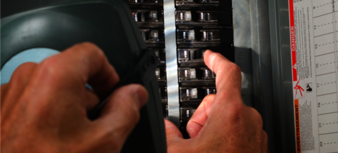

When you are constructing a house or redesigning your home and have to design the electric panel board there are many things that you have to take into consideration. The function of the main electrical panel is to distribute electric power to the various appliances and fixtures in the house. This distribution is done with the aid of electrical circuits that emerge from the panel. As a general guideline, it’s best to keep these few materials handy before designing the panel.

Two copper aluminum strips under the circuit breakers and the wiring panel are the power buses or hot buses that are connected to the incoming cable. Both the neutral and the wires for grounding are connected to their respective buses. These are present on either side of the power buses. The main breaker which controls all the power in the house is located on the upper part of the electric panel.
Step 3 - Consider Power Requirements
An electric panel in a house provides 100 or 150 or 200 amps. The individual circuits are then distributed from the main breaker by individual breakers which branches the power throughout the home. These individual breakers are designed depending upon the requirement of power. A light outlet circuit would need 15 amps and other appliances that need more power would usually be 60 to 100 amps.
