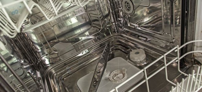

A dishwasher leak can cause many problems. If it is leaking enough you can see it, the chances are very high there is much more water damage you can't see, and a bigger problem then just a wet floor.

Step 1 - Check the Gaskets
Like most appliances, dishwashers have a rubber gasket around the inside edge of the door which helps to keep the water and soap inside. If this gasket is torn or cracked due to age, this could be the source of your leak.
To check the gasket, start by visually inspecting it for any tears. If you do not see any, take a piece of notebook or newspaper and insert it at the top portion of the door along the side.
Then close the door on the paper and try to gently pull the paper out of the door. Open the door and move the paper to the next space and do this all along both sides of the dishwasher. A dishwasher should have enough of a seal to make pulling the paper out difficult, so if it slides out easily, you need to replace the gasket.
