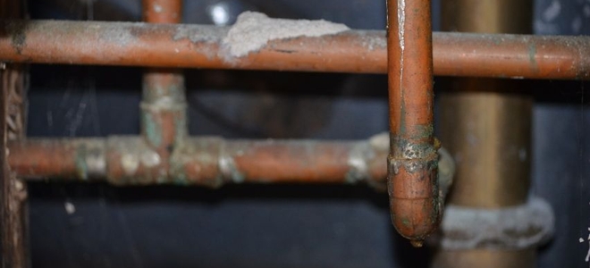

The copper pipe usually used in homes is soldered together using a flame. The heat from the flame causes the solder to melt and the two pipes are soldered together. These can be disconnected using a propane torch. The heat from the flame of the propane torch will melt the solder. This helps in dismantling the copper pipe. Follow the instructions below to successfully complete the task of disconnecting a copper pipe.
Step 1 - Safety Precautions
Before you commence working with the copper pipe make sure you have taken all necessary safety precautions. Wear safety glasses to protect your eyes. Leather gloves for your hands provide additional safety.

Step 4 - Turn on the Propane Torch
Make sure the gal valve is on as you ignite the propane torch. If the propane torch does not have a built-in igniter, you can use a match.
Step 5 - Direct the Flame on the Copper Pipe
The flame of the torch has to be four inches away from the piping. The flame should be targeted directly at the point where the copper piping needs to be disconnected.
Step 6 - Concentrate on the Welding
flame from a torch on a copper pipe
Once the direction of the flame has been set, it has to be used to heat the welding point of the solder which holds the copper pipes together.
Step 7 - Use a Wrench
Continue to apply the heat and once the copper pipes are hot, twist the copper fitting with the help of a strong wrench. This pressure will help in freeing the pipe. Getting a good grip on your wrench is important. Your body should be in a comfortable position. Only then will you be able to apply proper pressure with the wrench.
Step 8 - Free the Pipe
Increase the pressure on the wrench and keep twisting it until the copper fitting breaks loose from the pipe.
Step 9 - Disconnect the Pipe
The pipe joint can now be easily disconnected by pulling the copper fitting from the other pipe.
