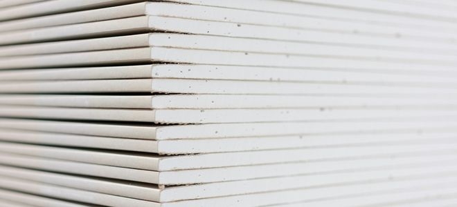

There are plenty of different materials that can be used to finish off an exterior wall. Wood siding, vinyl, brick, stucco, and a myriad of other materials offer outstanding protection and weatherproofing. One of the materials that people don't normally think about is drywall. Mostly an interior wall type covering, drywall can be used on exterior walls if it's protected from any long exposure to moisture, or if it's used as a base for other kinds of siding.
If it's the outermost surface, drywall will need to be sealed to ensure that is lasts as long as possible. If you are looking to install drywall on an exterior wall, here are the steps to take.
