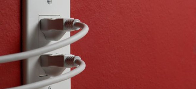

How to Extend a Wall Electrical Outlet
Two cords are plugged into an electrical outlet on a red wall.
