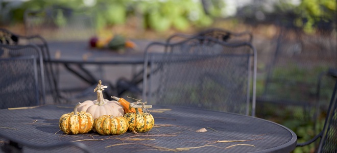

A metal patio table with pumpkins on it.

Metal
The process of fall-proofing metal is not that different from wood. Start by removing all signs of rust with sandpaper. This step can be the most arduous, depending on the condition of the metal, but just try and get as much rust off as you can. Be sure to wear the proper safety equipment whenever sanding a surface and try to do it in a well ventilated room. Once the rust is gone, treat the metal with a fish-oil based primer, which binds to the metal and any remaining rust and helps ensure the paint sticks. After the primer has dried, apply a coat or two of fresh paint. Black paint is a good choice because it holds up well against heat and moisture, though any color will do.
