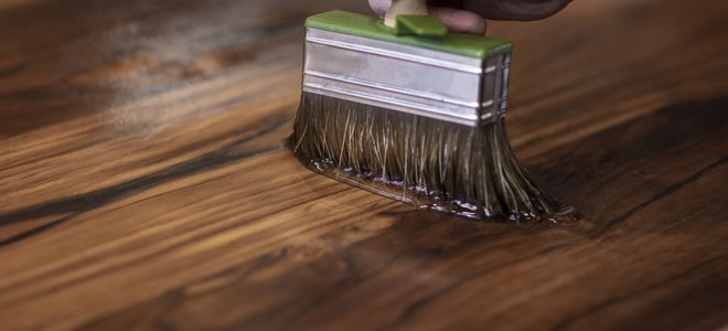

Step 2—Glaze the Cabinets
Once the paint has dried, you can add the glaze. You will want to work in small areas, about 2’x2’, and apply a thick coat of glaze. You will be using the faux brush to apply the glaze. The brush will add long stripe-like designs to the glaze. Be sure to work in the same direction throughout the entire unit of cabinets. If you start in a horizontal pattern, continue in that way through the entire project.
If you don’t like the way the design is coming, use your lent-free rag to wipe the glaze off and start over. The glaze will take a long while to dry.
Step 3—Finish the Faux Finish
Once the glaze is on all of the cabinets, you need to use the blending brush to go over the glaze. The blending brush will add a softer look to the faux finish. If you added a thicker coat of glaze, you will use the blending brush to add definition.
