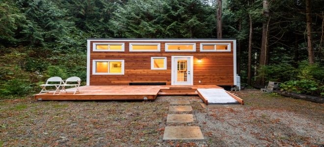

A modern tiny built with proper city codes home in a forest.
