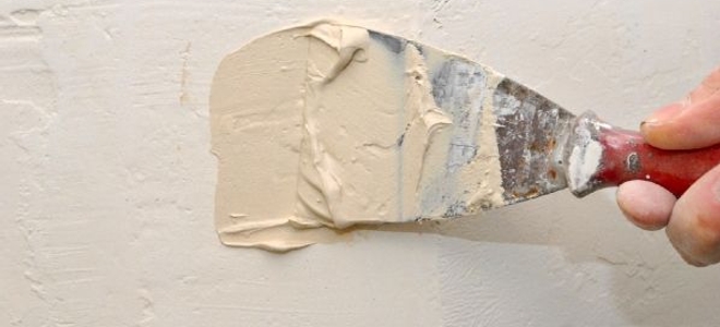

Step 3 - Mudding
Cover every seam, screw, and nail hole as well as all other imperfections with drywall mud. Mix the drywall mud and apply it with a putty knife over the bad areas. After it dries, sand it until it is flush with the drywall. Apply more drywall mud over the first application, but an inch or so past the edge. Sand it down again.
