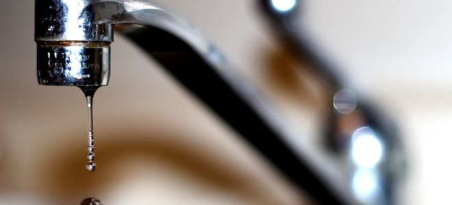

A leaking kitchen sink faucet isn’t just annoying, it can also cost you money. All that constant dripping is increasing your water bill, so it’s in your own interests to fix the kitchen sink faucet. It’s a very simple job, and something everyone should know how to do. Why pay for a plumber when you can fix a leaking kitchen sink faucet in minutes? In most cases, all you’ll need to do is replace the washer in the faucet.

Turn the water back on at the mains and then open the faucet to allow the water to run briefly. Turn the water back off and then observe if the kitchen sink faucet is still leaking. If not, then you’ve solved the problem. If it is, you might have the wrong sized washer in place. Turn off the water and disassemble the faucet, replacing the washer with one that’s the correct size for the faucet.
