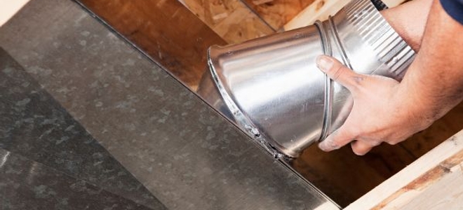

Framing a furnace duct isn’t a difficult project. If you have the right tools and the instructions, this project can be quite easy and fulfilling. Once you have cut the hole in the wall and installed the upright frame pieces in Part 1, you will finish the framing by installing horizontal cross pieces and finishing it with wallboard and corner beads. Follow the simple instructions below to complete this project.
