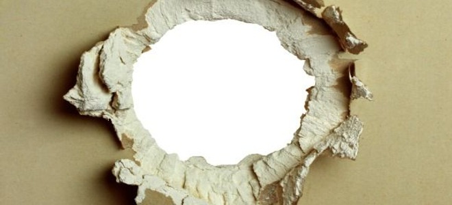

Step 3 - Cut the Drywall
Cutting basement drywall can be tricky, as drywall is not very strong. If you can remove the pipe to slide the drywall in place, then you simply have to make the hole. Choose a drill bit that matches the circumference of the circle and drill it out.
Use a jigsaw for holes that are larger than your drill bits. A drywall knife can also be used. For pipes that cannot be removed, you need to cut a channel. Cut out the circle for the pipe first and carefully remove the drywall from the circle to the edge. This piece of drywall you remove can later be replaced with mud and tape.
