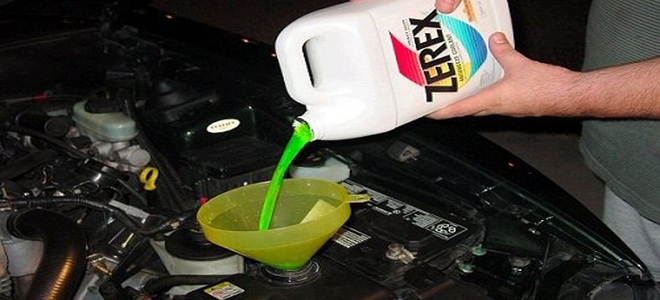

Mixing radiator coolant is relatively easy and won't take much time. It's best to do this in a bucket that you don't mind tossing out, especially if you have pets or small children roaming around. Some types of coolants will come in a jug that you can add the water to directly.
It may be a good idea to use gloves when you do this. This will keep the coolant off your hands if that is a concern. The mix should always be a 50/50 mix. If you are using a bucket, you will simply want to pour the contents of the coolant in to the bucket, then refill the coolant jug with water. Pour the water in to the bucket slowly to avoid splashing.
If the jug of coolant is designed to just add water, you will need to find the fill line and add water to that point.
Step 3 - Add Coolant
Newer cars will have an overflow tank next to the radiator. The overflow tank will have markings to show you if the levels are low. You will simply add the coolant to the tank when the car is cool.
An older car may require you to add the radiator fluid directly to the radiator.
