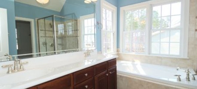

A view of a master bathroom vanity and tub set up.

Our bathrooms are sometimes neglected because we concentrate on the areas of the house that people see when they first enter. We spend time meticulously decorating our living rooms and dining rooms to make a good first impression, but when someone walks into your bathroom, a tired-looking vanity can make your entire decor look dated, no matter how pretty the shower curtain. Fortunately, it's not difficult to switch out the old vanity with a new one to update your bathroom's look.
