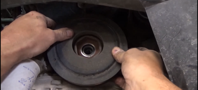

Locate the crankshaft pulley inside your engine and you will see how removing the tire helps you gain access to it. Lift the front section of the car up on a floor jack. Once the car is secure, remove the lug nuts and the tire. You may need a special socket if you have locking lug nuts. When the tire comes off, keep it aside.
Step 3 - Remove the Splash Shield
Once you remove the wheel, it is time to remove the splash shield. The splash shield usually stands on the wheel well and is held together by rivets. These are easily removed using a regular screwdriver. Keep the separated parts safe, as you will have to reattach them post installation. It’s a good idea to take pictures along the way if there is any question about how things will go back together. Also label any hardware you remove. You will see the crankshaft pulley right behind the removed guard.
Step 4 - Install and Connect
crankshaft pulley
With the splash shield removed, you now need to replace the crankshaft pulley. First, remove the old crankshaft pulley. You will find that this is secured or threaded by means of the crankshaft and may require some special tools. In modern cars with automatic transmission, the main bolt that holds the pulley in place will spin endlessly if you try to remove it. An impact wrench is best for this job and you may need to ask your mechanic to loosen it if you don’t have one. With the bolt off, you likely will not be able to remove the pulley by hand. Instead, use a crankshaft pulley kit to remove the pulley.
Once the old one is removed, you can reattach, or re-thread, the new pulley into place in the same manner. When you are sure that the new pulley is held firmly in place, fasten the splash shield back on, followed by the tire. Next, remove the floor jack and attach the disconnected cable and battery.
