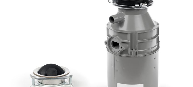

The pieces of a garbage disposal unit isolated on a white background.

Installing a food waste disposer (also known as garbage disposal) might seem daunting, but it is a straightforward task that can be completed in about 10 steps, outlined in the instructions below.

Step 3 - Attach Mounting Assembly
Separate the parts of the mounting assembly from the disposer. Then, loosen the screws of the mounting assembly, and remove the snap ring. Place a 1/4-inch bead of plumber´s putty around the drain opening in the sink, and drop the new sink flange into the drain opening and press it into place. From under the sink, slide the fiber gasket and backup ring onto the sleeve, holding these pieces in place. Finally, slip on the mounting ring and snap ring.
