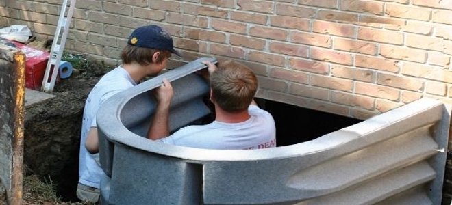

A metal window well can be installed either during or after construction. While the project is easier during the initial construction process, it's still fairly easy to install after the fact. Window wells allow you to add natural light and ventilation to areas of the house under the foundation line.

Step 3 - Place the Well
window well
A metal window well will be easy to slide into place. Depending on the size of the well you are creating, the metal may be placed in sections. The base section is placed first. The rounded sections of the well will be placed next.
Step 4 - Bolt to Foundation
Most window well kits will come with anchors that can be used to keep the well secure against the foundation. Attach these anchors before you begin to backfill.
