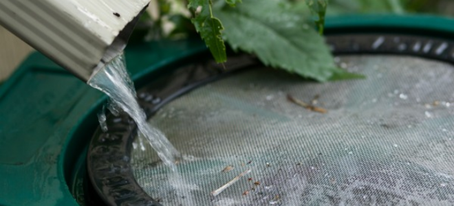

Gutter directing rainwater into rain barrel
