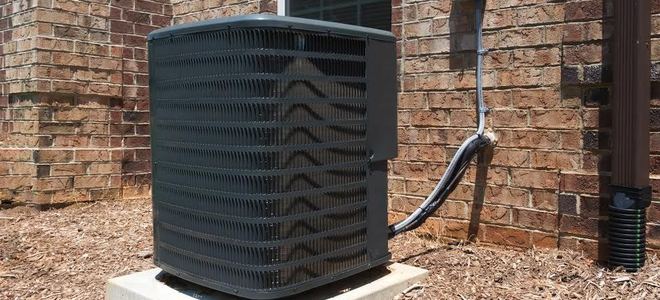

How to Install an Air Conditioner Fan
air conditioning unit outside a building
