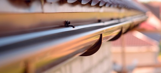

A quality eavestrough system secured to your roof can be an important part of your home's drainage system. Not only does it keep water out of a basement, but also it protects a home’s foundation from water damage. Luckily, aluminum and vinyl eavestroughs are easy enough for any do-it-yourselfer to install.

Starting on the opposite end of where the downspout will be, make a mark 1/2 inch below the edge of the roof. Next, calculate the slope the eavestrough system will need. Make sure that the line is level, or your calculations will be off. An eavestrough system should slope 1/16 inch for every 1 foot it runs linearly. So, if the distance to the downspout is 10 feet, the eavestroughs should be 5/8 inch lower on the downspout side than the side where it began.
Since the eavestrough system is going to be mounted at 1/2 inch below the roof’s edge, if the trough must span 10 feet, the downspout side should be mounted at 1 1/8 inch lower than the roof edge.

Using a drill with a screwdriver bit and rust-resistant screws, fasten the mounting brackets approximately every 2 feet along the sloping line left by the chalk line. Install any elbows and downspout brackets in the same manner.
Step 6 – Mounting the Eavestroughs
Once the mounting brackets are in place, fasten the eavestroughs to them. If a trough needs to be cut to fit properly into the drop outlets or elbows, use a hacksaw. In the places where the eavestroughs meet, join the pieces with silicone caulk to keep water from leaking through the seams.
