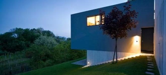

A modern house sits on a hill in twilight.
