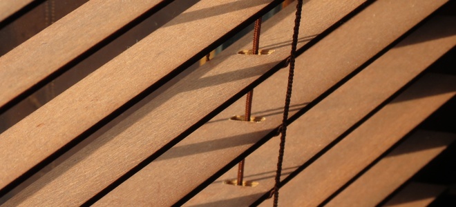

Interior wooden shutters can be used to add details and style while providing security as well. They are easy to install and as they are much smaller in size compared to outside mounts, they tend to be inexpensive. To improve their security function, they can be easily fitted with magnet latches. Magnetic latches are uniquely designed to for easy mounting.
