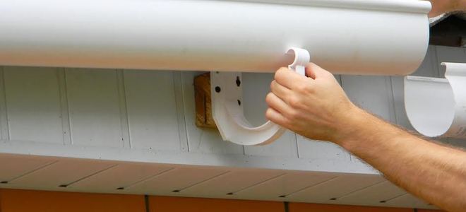

Step 5 - Install Gutter Hangers
Gutters on a house.
The gutter hangers should be spaced about every 2 feet or less for proper support. The key to installing the hangers correctly is to screw them into the rafter boards, not just the front fascia. If you do not screw the hangers into the rafters, you run the risk of the gutter falling when it is filled with water. Once the hangers are in place, you can install the gutters and attach them to the hangers via screws.
