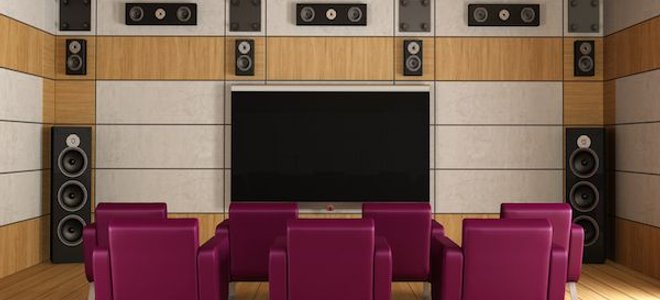

How to Install Surround Sound
home theater complete with a surround-sound system

You can vary the locations of the speakers to some degree. The most appropriate location for the center speaker is either directly below or above the television. The left and right front speakers should be placed 5-10 feet from the left and right sides of the TV. The surround left and right speakers should be placed behind the left and right of your seating location.
