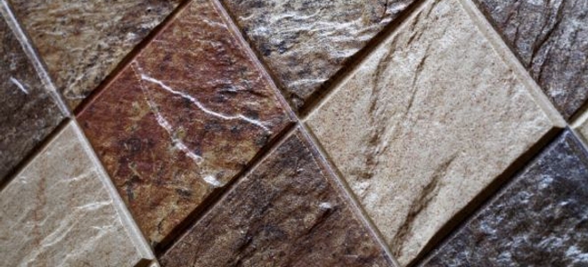

Tile the area or wall from the bottom up. Mix tile mortar and secure each tile on the wall. Ensure that the tiles are aligned properly and that no gap is left between tiles. Continue adding the tiles until you reach the plumbing spots.

Take the measurement from the above step and trace them onto the tile. This tile will be cut accordingly and will be placed on the pipe opening. Mark a circle that is .25-inches wider than the pipe opening. Make accurate marks.
Step 5 - Cutting the Tile
After marking the path, cut the tile accordingly using a saw. The carbide rod will be the apt tool for this kind of job.
Step 6 - Testing
Once you have cut the tile according to the measurements, place it on the pipe opening. If the opening is completely within the tile, then you may proceed to the next step. If there is any contact, then you will have to further chip tile away with the rod saw.
