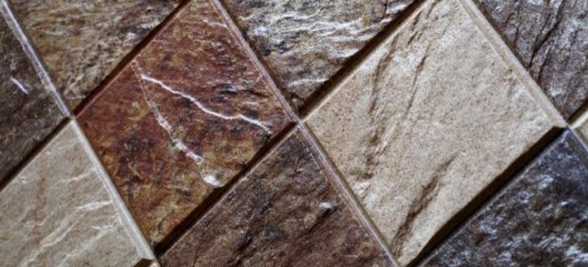

Put on some work gloves while applying adhesive. Butter some tile adhesive onto the "+" area and leave a very tiny gap for the pencil mark to stay visible. Next, take 1 tile and holding it with the diagonal point facing up, lay it on the adhesive a tad below the center point. Line the pointed edges of the tile up exactly with the perpendicular line so that it remains true to your vertical mark.
Step 5 - Continuing
Place another tile along the bottom-right edge of the first tile and place a spacer in between the 2. Add another spacer above the second tile. You can now place the third tile along the top-right edge. You should have 3 tiles in a "V" shape with the tops of the "V" both just a tad from the horizontal line. Take your level and make sure your tiles are still straight.
Step 6 - Pattern Creation
Repeat step 5, but this time lay the tiles to the left of the first tile. You should end up with a "W" shape.
Step 7 - Direction
Complete the course from center to right and center to left, leveling your tiles every time you get 2 tiles down. Your first course should have a jagged structure to them. You will now have a half tile space left on either side. We will discuss this later.
