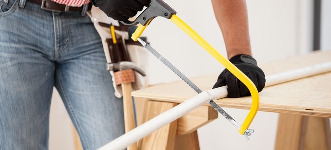

cutting white PVC pipe with a hacksaw

If the PVC pipe isn't already cut, use a hacksaw to do so. Then, prime the cut PVC pipe and adaptor with “purple primer” for PVC pipes. Apply cement around the joint to ensure the pipes are completely bonded. Once you’ve coated the pipe and connector with cement, slide the pipe down as far as it will possibly go.
