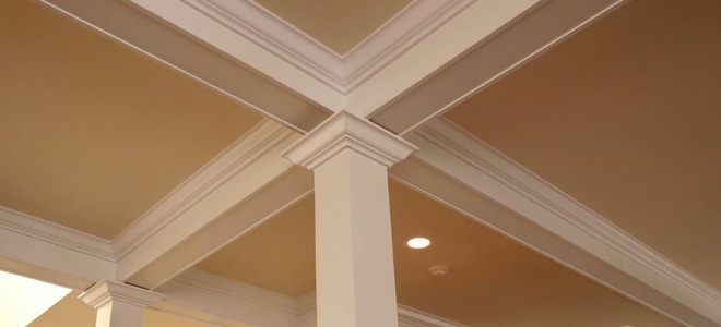

Crown molding trim enlivens a room and adds a measure of elegance by covering up the plain intersection of walls and ceiling. In other words, crown molding frames a space. The decorative wood trim comes in numerous styles with varying degrees of ornamentation. Whether painted or naturally finished, crown molding completes a room. Cutting the crown molding to the correct length and angle is the most difficult part of its installation. On occasion, you may find that you need to join 2 pieces in the middle of a wall. Known as splicing or a scarf joint, this task is fairly simple with the right tools.
