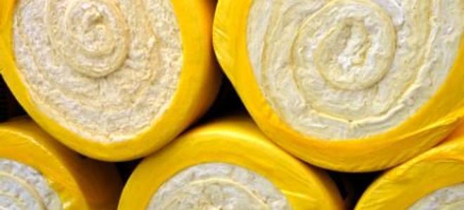

An end-on, close-up view of white rolls of fiberglass insulation material.

After you have bought blanket insulation with the appropriate r-value and have the necessary safety gear such as protective eye wear and a breathing apparatus or mask, you are ready to install your insulation. Simply cut away the packaging and roll the strips of insulation out across the attic floor.
Do this process for the entire length of your attic. Tuck the pieces in tightly for the best level of insulation. For insulating your attic walls, you will need a stapler to secure or fasten the insulation as you roll the blanket sheets out. Using the stapler is quick and simple. Just strike the section of framing to discharge the staple and fasten the blanket insulation.
