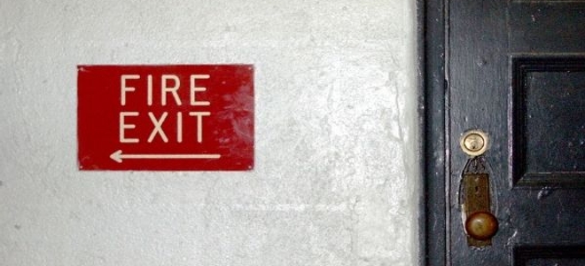

Step 4 - Prepare Signs
Fire egresses need to be clearly marked. Overhead illuminated signs over fire exits are required in most cities. Some places require that the signs be written in both English and Spanish. Others require pictures to make them easy to identify. Signs placed directly on doors that are fire doors are also required.
