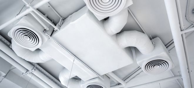

An air to air exchanger is a useful device if you want high quality indoor air. It draws fresh air from outside through a port into the house. Filters capture the dust, allergens and other pollutants from the outside air. This air is channeled through a chamber surrounded by indoor air. Special materials extract the heat from the outdoor air and transfer it to the cooler, indoor air.
The fresh air is then distributed throughout the house via ductwork while the warmer air is expelled to the outside. The energy exchange involved may cause condensation of humidity into water. This water is collected in a drain pan housed inside the unit. A well maintained air exchanger not only gives you high performance, it also lasts longer in good shape.
