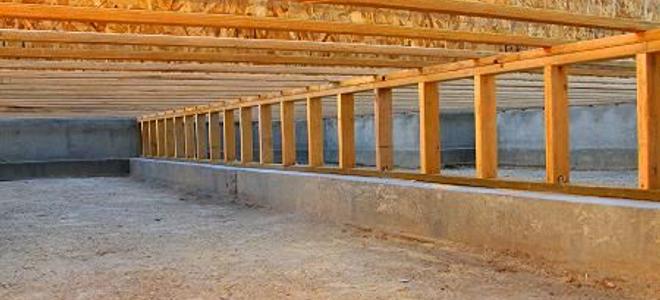

How to Make a Crawl Space Vapor Barrier
An unfinished crawlspace.

Making a crawl space vapor barrier is a great way to keep harmful water from collecting on pipes and foundation walls beneath a house. Water that is allowed to collect there can mold, rot wood, rust pipes, and freeze during the winter, which causes cracks in the foundation. To keep water out, all you need is a few materials and the willingness to crawl through the small area under your house.
