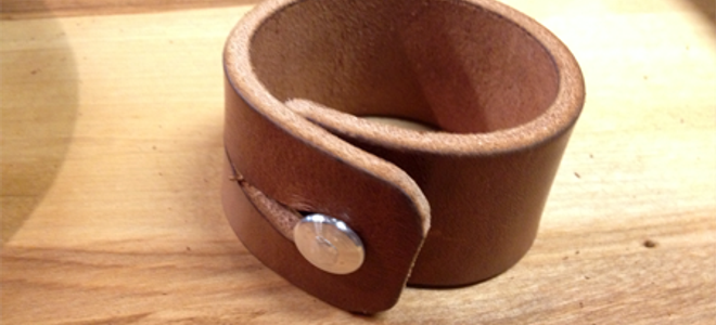

Optional – Finishing Touches
leather cuff finished
Before adding on the fastener, you can apply a stain, balm, or conditioner to the belt to get the look you want. If your leather is completely untreated, you'll want to treat it to keep it from staining from water contact. Make sure to follow the specific product’s instructions, but be prepared to get a little messy and have rags handy. You want to use smooth strokes to let the product penetrate the leather evenly throughout.
Different types of leather wax can also help keep any frays in place. This can be applied after the products listed above to finish off your new accessory.
