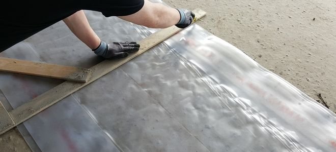

Cut the screening to fit and staple it securely to the wooden inserts inside of the framework. Use a width that will allow both sides to bear on a wooden edge and trim off the excess with a razor knife wherever necessary. Attach the glazing that you've chosen securely to the frame, and call it a day.
Clear plastic sheeting works just as well as glass for this application, but it's far cheaper to replace plastic sheeting in the long- run. You can get really fancy and install ducts and a thermostat-regulated fan, or you can go with the easier convection unit and avoid having any moving parts or electric bills.
