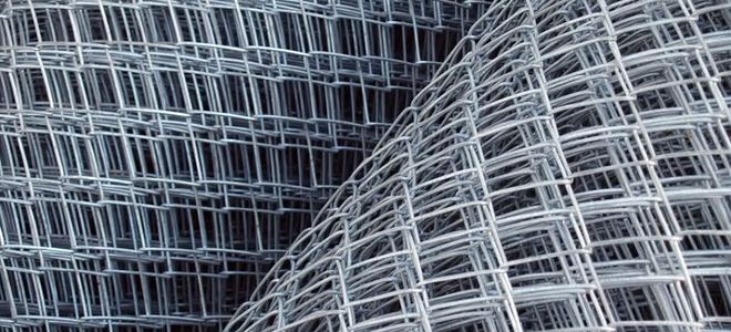

A wire mesh fence is simple to build, but it has the advantage of being cheap and resistant. Being a cheap alternative to other types of fencing, it is a good idea to learn how to make one. It can be used to mark property lines, avoid intrusions and it is ideal in case of animals, since it is safe.

Step 9 - Attach the Wire Mesh Fencing
Then, once the posts are ready you can start attaching the wire mesh fencing to one of the corner posts. Pull it towards the next post in the line and stretch it well so as to avoid a sagging in the final fencing. It is best to nail it to each post at least at the top, bottom, and at least at two spots in between, as this will help to stretch it out tightly. Continue this procedure until all the wire mesh fencing has been affixed to all the posts.
It's best to use woven wire mesh rather than the welded type. Use a fence stretching tool. This will help you to make the wire tauter since it will be pulled and stretched effectively and consequently reduce the possibility of drooping and sagging. To fasten the wire mesh use fence clips or fencing nails as these are ideal to secure the fencing to the posts effectively. In fact, these types of clips nail straight and securely into the fence posts and are specialized for fence building projects.
