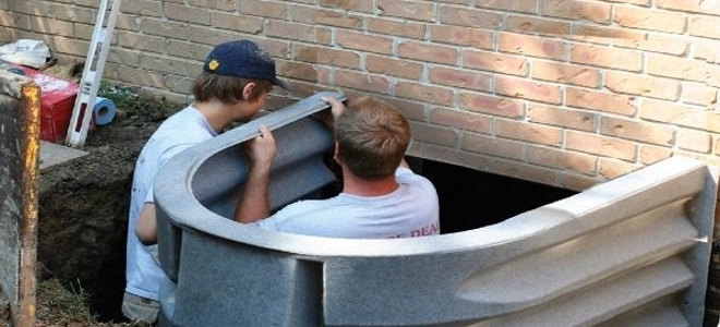

Step 5 - Install the Window Well Kit
It is advisable to have two people lower the well kit into position. Follow the manufacturer’s directions. Once the well is placed in the hole, the flanges will be lined up within equal distance of both sides of the window. The kit will include gaskets and seals that need to be installed before attaching the well to the wall. After the well kit is installed, add approximate 5-inches of drainage gravel to the exterior lower rim.
Top off the interior drainage gravel to the recommended depth. If local building code inspection is required, have that done before back filling the outer rim of the well. Once the well has passed inspection, fill in the back area with dirt. Top off with drainage gravel or landscape the area.
