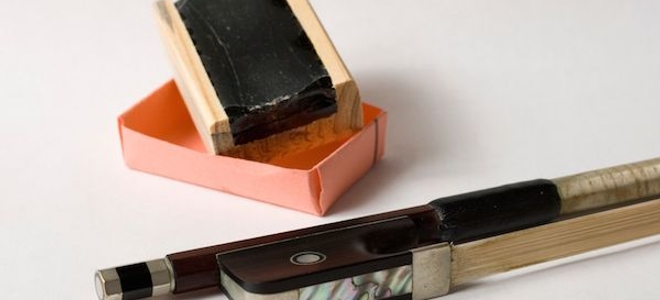

Violin rosin is an ingenious gum that performers use to treat the horsehair bows that entice beautiful sounds from gut strings. Rosin is a necessity in every violin case, and serious performers always keep their favorite brand or blend on hand. Because the basis for violin rosin is usually pine resins or a blend of saps from other conifers, it’s easy to make your own.

Violin rosin is the product of pine rosin combined with other resins, waxes, and other ingredients. Different rosin makers use different recipes, and some makers keep their ingredients secret. However, you can simply melt the pure rosin from the distilling process, and combine it with beeswax, which is sold by many vendors.
Adding Metal and Allowing to Cool
Keep in mind that resin collected in the spring and fall will generally produce a darker, softer substance. Add metal flecks to the mixture to add an abrasive texture. Mix well, and pour the rosin into a wooden mold. Allow it to cool, and your homemade violin rosin is ready to use.
