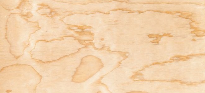

Since you are making AA plywood, you probably want to use hardwood. Plies are thin sheets of wood cut from a roller log with a blade. Plane off some sheets of lumber or buy them from a hardware store.
Grade A plywood is knot free and the faces are sanded smooth to make them ready for painting. By contrast, Grade B plywood contains small knots and splits, but is still sanded smooth.
