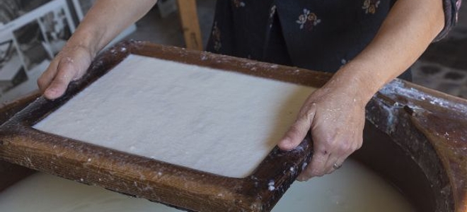

Step 2 - Make Paper Pulp
Tear selected paper samplings of news and scrap paper into 1-inch pieces and place them into a blender, filling until it is half-full. Carefully pour warm water into the pitcher until full, and mix on low for 1 minute (or until blended).
A pile of ripped paper squares in different colors and patterns.
Should you wish to create colored paper, add natural colorants such as powdered beetroot, Spirulina, or even finely ground carrots to the mixture. Continue to blend until satisfied with the color.
Step 3 - Pour the Pulp onto the Screen
After placing the screened mold in your tub, pour the contents of the blender onto the screen, allowing the excess water to drain out of the bottom. Gently rock the mold side to side, distributing the mixture evenly.
A sheet of white homemade paper with green and purple traces of color and flowers pressed into it.
Should you wish to add fresh herbs to accentuate the eco-friendly nature of this project, simply sprinkle them into the paste during or just after pouring. The added texture will create a lovely, unique look to the paper.
Step 4 - Allow the Paper to Dry
A row of wood frames with homemade paper in them drying against a fence.
Once the excess water has been drained, simply lay the mold upside down, allowing the newly formed paper to fall onto a towel. Pat dry as necessary and allow to sit for 24 hours before use.
