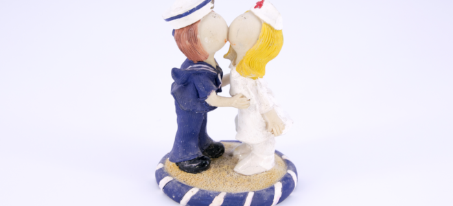

Acrylic resin is used to make all kinds of things, from statues and toys to furniture. If you buy something made from acrylic resin that is not finished, it won't look very stylish. Acrylic resin, even in its raw and unfinished form, can be painted. Buying something made from acrylic resin without it being finished can save you some money. If you go this route, or even if you make your own, you will need to prepare and paint the acrylic resin yourself. Here are some pointers to help you accomplish that task.
