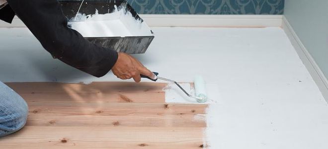

Step 3 - Paint a Coat of Primer
Cover the entire floor in a coat of primer, painting it on with a roller as you would with paint. It isn't strictly necessary to use primer, but this is the best way to get good, clean coverage and paint that will look better, longer. Let the primer dry completely before proceeding.
Step 4 - Begin Painting the Floor
Apply thin coats of paint to the floor, one at a time, letting each dry before you apply a new coat. You may need multiple coats to get the coverage and the color you want. It can be tedious to paint floors, but if you're patient, the end result will be as stunning as you imagined. Let at least 24 hours pass between each coat you apply.
