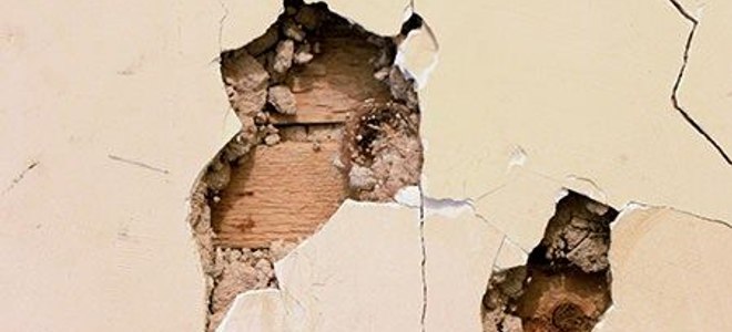

Interior walls made with drywall can easily be punctured, whether by a doorknob, the back of a chair, or something else. Therefore, if you’re a homeowner, you should know how to patch drywall. Luckily, patching drywall is an easy project that you can complete yourself. Here are a few tips to help you get the job done quickly.
Widening and Smoothing Holes
Before you can fill a hole in your wall, you need to smooth the ragged edges in the drywall's outer surface paper. To smooth the edges, use a sharp edge of a utility knife to shave off paper edges protruding from the hole. If necessary, push the edges into the hole by making a slight dent. It’s better to fill a dent than to have a rough surface when finished.
