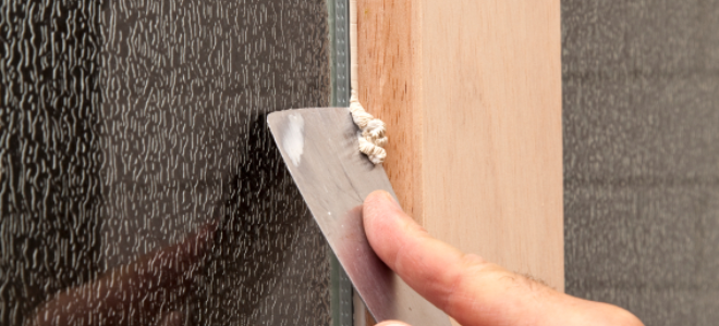

Step 1 - Remove Old Putty on Windows
Before putting more putty on windows you will need to remove the old putty that is already there. Use a putty knife to break the existing putty up into smaller pieces. Scrape away until you have removed what you can without going too hard. This will probably be the larger pieces.
Step 2 - Heat Putty with Heat Gun
blue heat gun
Trying to remove all of the putty with the putty knife will only result in gashes in the wood frame and scratches on the window pane. Once you have removed all that you can with the putty knife, use a heat gun to soften up the remaining putty. Hold the heat gun about eight to 10 inches away from the wood and continually move it back and forth across the section with putty. Don't hold it too close—too much heat will crack the window. Work at the soft putty with a plastic scraper or small putty knife. Make sure it's all removed.
