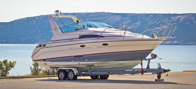

When you cannot dock your boat, you will need the services of a boat trailer. A boat trailer is essentially a steel platform on wheels towed by another vehicle. It is outfitted with girders and rods that support and hold the boat safely in place to not damage the hull. This is why the boat trailer supports are carpeted. Over time, the carpet can peel off the metal and needs to be replaced. There are two types of carpet: snap and glue. The following article will show you how to replace them.
